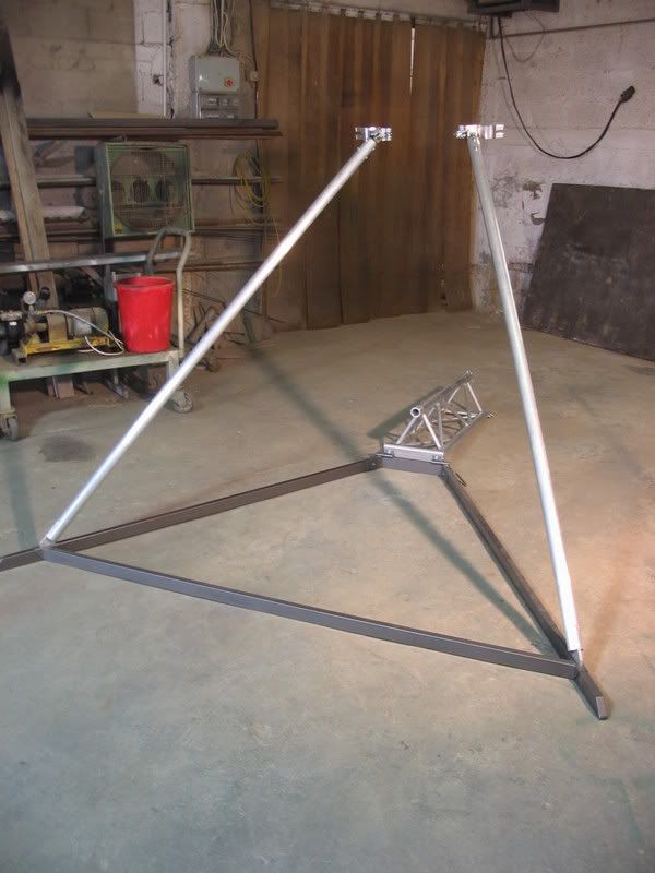

O.K. I'm done,
Yesterday I run a final assembly routine in the workshop, checking everything fits, connects, lifts and works as disigned...
I assembled the LAMPost single handed in a few minutes, though in real life I'll have another person with me so it will really be a breeze.
Here goes:
1. Laying the 1m truss section, with attached 'ground pivot'.
2. Attaching the ground legs/beams.
3. Laying the front cross beam in place.
4. Connecting the outriggers.
5. Flipping the 1m truss forward.
6. Connecting the 3m truss section, carrying the top beam, crank and cable.
7. Raising the complete truss and attaching to the outriggers.
8. Connecting the lift frame.
9. Hanging the speakers.
10. Up, secured and ready to fire...
In a week's time i have an outside gig in which I'll be using this system for the first time.
Can't wait
